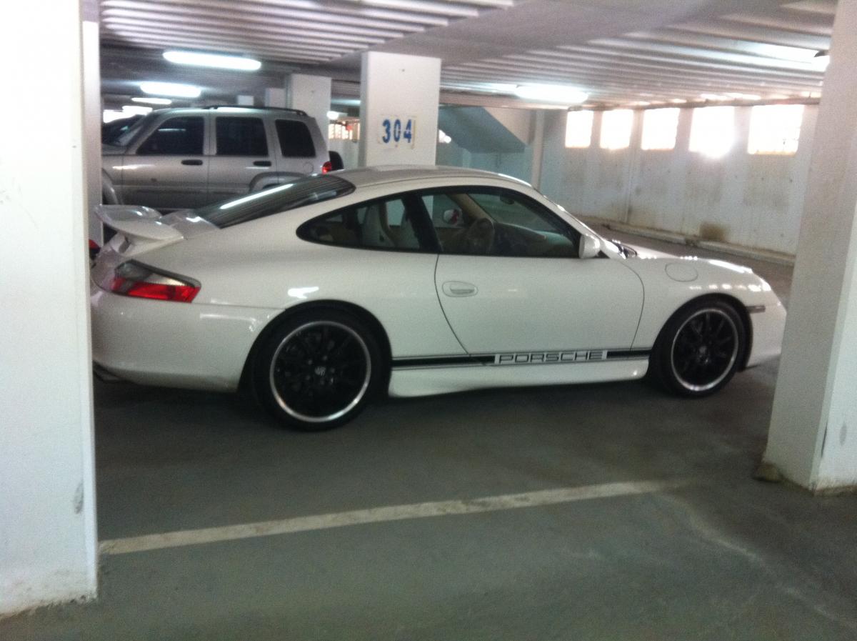

Hi there,
Now sure if the image came through as I am struggling to upload a photo. My car has had 5mm spacers fitted with painted 18" Alloys (polished rim) and lowered sports suspension (M030 ROW 10mm lower pack). All Porsche parts, this will hopefully give you an idea of the look of a car with the mods you are looking to do.
Hope this helps
