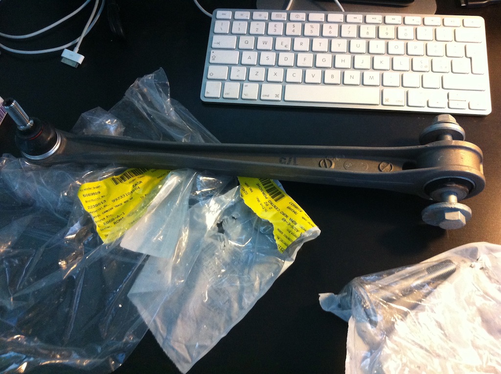

new parts ready to be mounted...

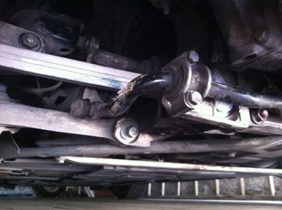

it is not supported on that particular wheel! it took me four hours to get rid of that toe bar bolt!
post-36228-0-89331100-1327750750_thumb.j
post-36228-0-13969000-1327750762_thumb.j
