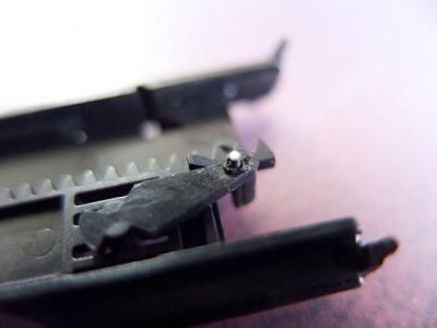

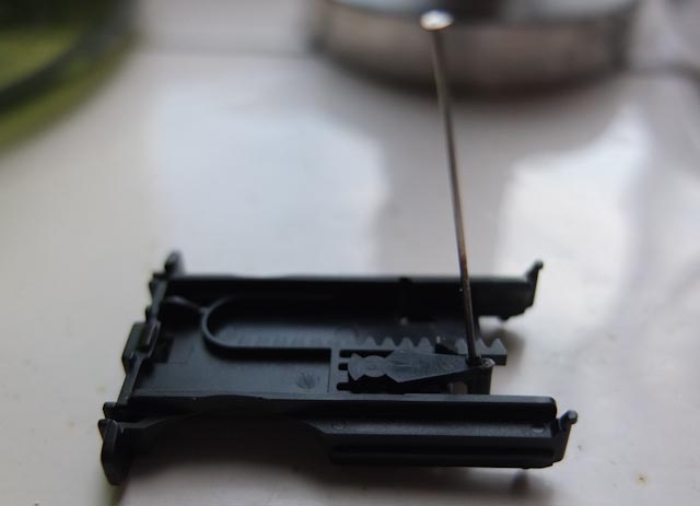

After following guide i had the tray mech. in my hand , so i decided to take it apart by removing the 4 tiny hex screws. There was the broken arm , a 3mm lug of plastic had broken off. so i got a red hot pin pushed it into the arm where the lug had broken, trimmed to down with snips, filed it smooth and hey presto, better than porsche design and 10x stronger!
You can check the action to make sure it works just right before reassembly .
Boy was i pleased with myself!
