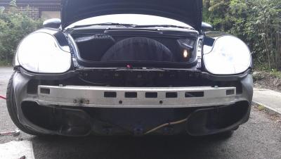

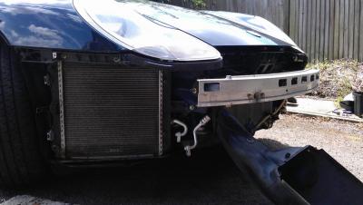

Today I removed my front bumper to fit my new drivers side condenser. It certainly looks like I am the first person to remove the bumper and clean away the dust dirt and leaves, but luckily there wasn't much lodged behind. Nothing compared to some other cars i've seen on these forums. I think the car has always been kept in a garage during it's life so this may have helped.
The old condenser was in fairly good condition and didn't show any visible holes where the leak may have come from. I did notice the rubber o-rings were perhaps a little perished and stiff. These rings connect the pipes to the condenser. I swapped it for the shiney new one and fitted the new rubber rings. I also replaced the two o-rings on the passenger side condenser.
I will be taking the car for a gassing next Saturday. Fingers crossed.
When I disconnected the passenger side condenser, some oily liquid dribbled out of it. Only a small puddle. Does anybody know what this if for and if should be there?
Also i'm interested to know what the yellowy coloured hose that runs to the centre of the car then connects to the black hose is? See my front image, right in the centre under the metal bumper.
Thanks.
