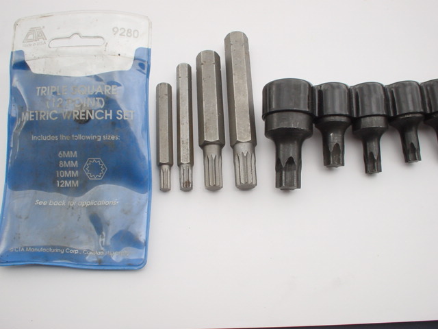

Is it a T20 and not a triple square head?
'T' stands for torx which has 6 points.  Triple square has 12.
Thanks for clearing that up.
Again, are the fasteners, on the vehicle, Torx or triple square?
Porsche uses both.
For example, look at the screws for the visors.  Those are torx.  Look at the screws for the door latch on the door sill.  Those are triple square.
Does blakbox know that the seat track fastener which he thinks is a T20, may in fact be a triple square?

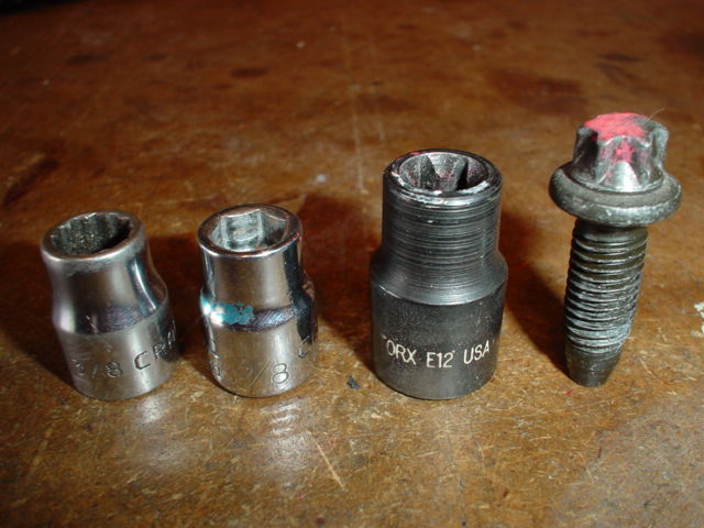

E is the female version of torx. The bolt to the right is a seat bolt.
The second picture is triple square aka cheesehead aka XZN, on the left. Male torx on the right.
