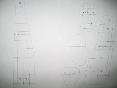

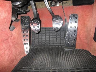

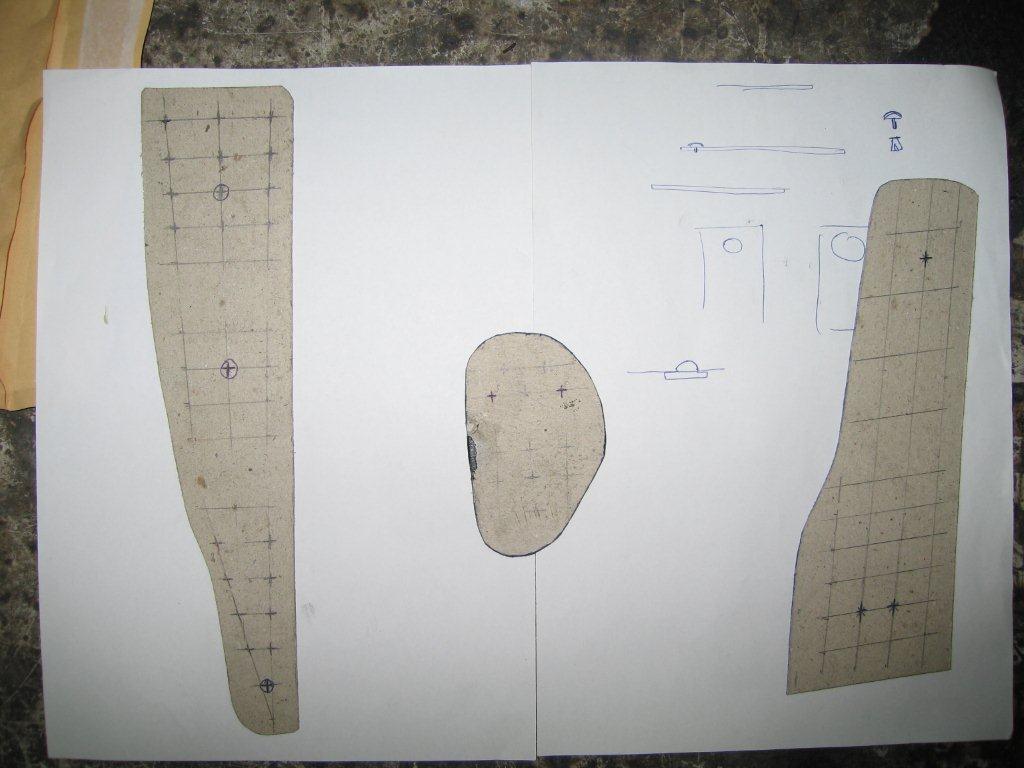

Been trying to find a pedal set for my RHD Boxster S, and eventually decided to do my own. So here goes and enjoy. The plate is 2.5mm stainless, then brushed it a bit to decrease the mirror finish. The black plastic rivets are purchased from 'Wurth' auto parts. You need to copy the curve on the clutch and brake pedals, and carefully, on a pipe you shall need to bend it accordingly. The foot rest and gas pedal are attached with self tapping screws, however the clutch and brake are bolted. all with countersunk heads. Do not do this fitting job after a meal!! Regards Jojo Bonett
