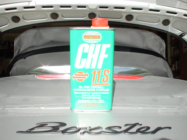

1. Yes.
2. No. It is Pentosin CHF 11S, in the green can. It is synthetic and I do not know of a substitute.
It is about $25 or so dollars a liter. Unless you have a leak you just need 1 or 2 oz, but you have to buy the liter can which will last the life of your car. You can find it for less on the internet but then you have to pay for shipping.
At our local work on cars days someone usually brings their used can for the cars that need a sip. I buy it from a local import parts place that sells BMW stuff since it is also used by BMW.
