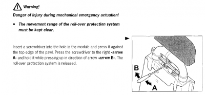

I rear ended a car today, and the roll bars popped out.
It was not a strong inpact, and nothing happened to my bumper, but the roll bars popped out.
Anyone can tell me how to put them back in. Thanks.
Just press them down until you feel them latch again - find and replace the covers.
If your seat belt locks fired then your seat belt retractors/belts will need to be replaced. They can only be fired once.
Hi Loren, I tried that, but they won't go in. I am assuming that there must be a release latch to keep them from going down,
otherwise in a roll over they would be useless. i can't even open the top because they are in the way.
Seat belts are fine.
