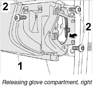

Preliminary work
1. Remove right instrument panel cover.2. Remove trim under instrument panel at front passenger's side.3. Remove right footwell light.4. Remove cover (cold air bulkhead).5. Remove right center console cover.6. Remove cup holder.
Removing glove compartment
1. Unscrew right fastening screws 2 from the glove compartment 1.

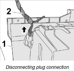

2. Pull electrical lead out of glove compartment arrow.3. Unscrew left fastening screws 2 from the glove compartment 1.
4. Unscrew top fastening screws 2 from the glove compartment 1.
5. Carefully pull out glove compartment 1 ( arrow ) until the electrical plug connection can be removed.6. Pull off electrical plug connection 2 ( arrow ) and remove glove compartment 1 to the rear.
Installation is the reverse - all screws 2 ftlb. (max)
