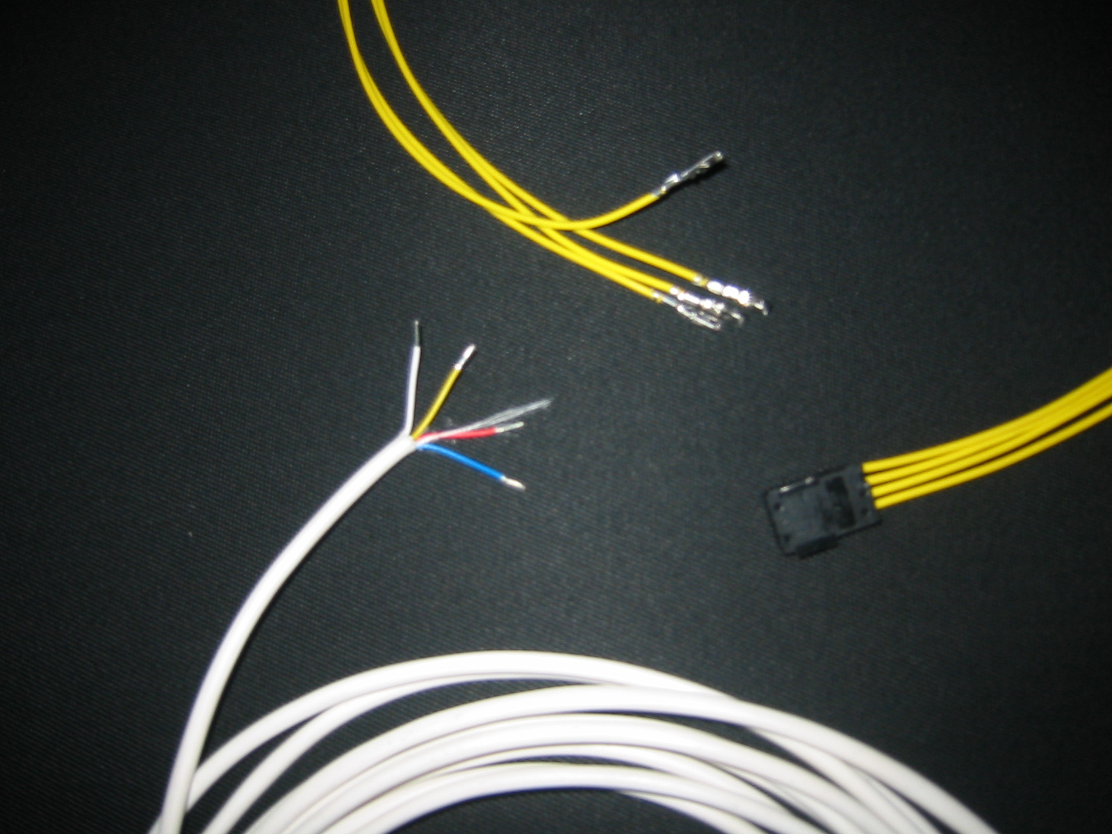

1) You don´t do anything, The clutch control switch is there. (should be :jump: )
2) The connector you buy is only the connector alone, you will need to sample the connector with the wires you also buy :eek: and then run those wires to the Motronic unit.
At the Motronic unit there are several connectors, You take connector IV and mount the ekstra wires in that connector.
Then the PST2 activation and :drive:
If you don´t have OBD display allready it is the perfect time to do this hack also.
I have done both at the same time on my car.
Good luck :clapping:

Hey Richard.
I can´t really remember if it is the 009 or 010 wire connector that goes into the motronic plug. The difference between the 2 are very small and the only way to find out will be to try. Probably both will fit, but 1 of them will slide easy into the plug. ( I think I payed 6 USD. for 10 )
Both the 009 and 010 are female connectors. When you buy them they are fitted with a piece of wire between, cut the wires in half and insert a wire in the correct length.
