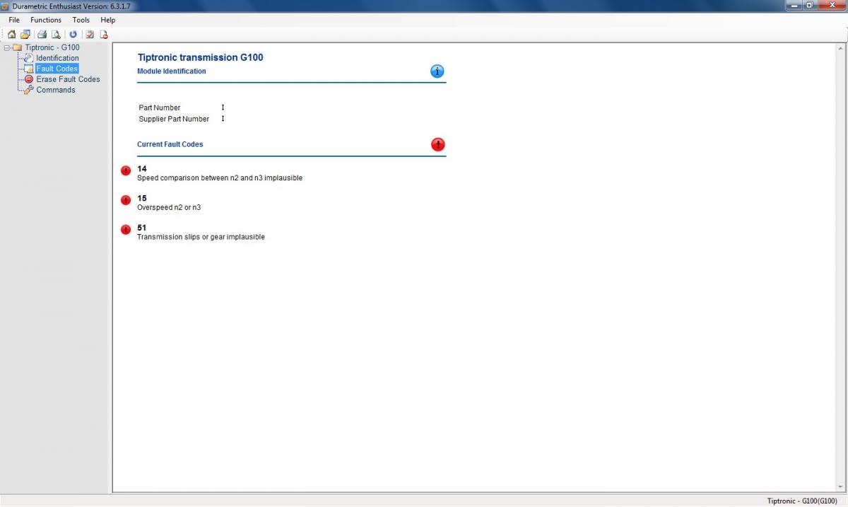

Help with Tiptronic codes
Those are all relating to a mechanical slip. If you can feel the slip, then cross your fingers a Porsche shop can bring it back with simple service. If you can't feel the slip, then a possible Piwis update will take care of it (longshot). Likely though Tip is on its way out.
