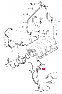

I'd never heard of this or knew what it did, but if you have a TT (mine is an 04) you should check it for a broken diaphram or cracked lower hose. The part # is 948 107 219 50. My Porsche tech pointed out the torn diaphram to me and I found the cracked hose later. The hose seems to connect close to the left turbo (US driver's side). If anyone has more info on what this engine vent check valve does please chime in! Oh, and I found a new one online for about $85

If its what I think it is is the check valve which holds pressure on the gas system while you fill up. They fail and you get strange starting after a fill up
this is a pic. It is next to the other check valve.
