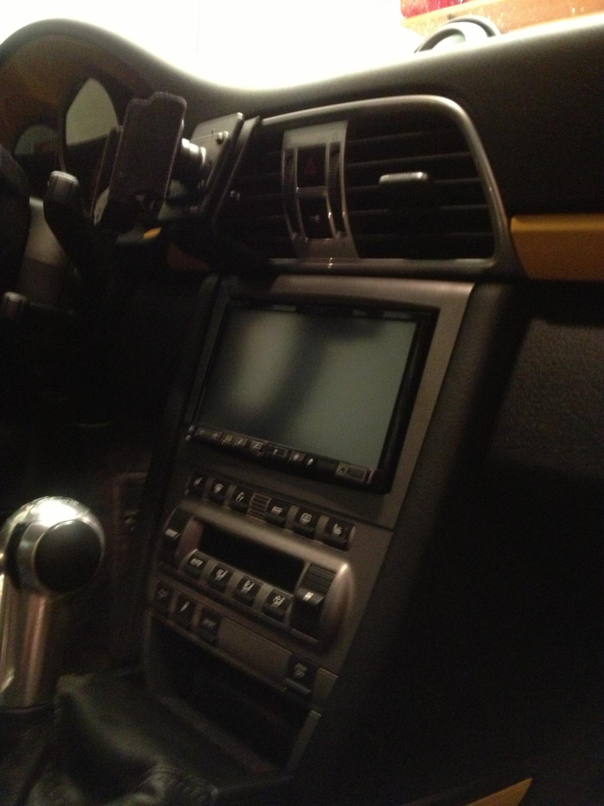

post-89070-0-26840400-1370741441_thumb.j Hank, I had exactly the same concerns. I have had the new system in now for 6 months and it has worked flawlessly. I was lucky to get hooked up with a GREAT installer, Sound in Motion in Brighton Mass. I watched them do a more complicated install in a 997 cab using the NavTV module and they obviously knew what they were doing. Make sure whom ever you use has experience with 997s and the NavTV Most head unit replacemant module. This module is critical as it allows an analog head unit to communicate with the rest of the factory system. With my Alpine INE 927 HD the Bose system sounds terrific. I have had absolutely no issues with other equipment. The Nav is way better. iPod/iPhone integration is as good as it gets and BlueTooth works as well as any other system I have had experience with. PCM is hopelessly outdated. If you have the Bose system do not let the installer talk you into new speakers and amps. You will have to spend a fortune to do better and they will have to tear your car apart to do it.
The funny looking business hanging off the air vent is a ProClip iPhone mount. I have the Escort Live system which BlueTooths your radar detector to Escort's cloud via your iPhone. The iPhone then reports any traps coming your way reported by other drivers/detectors. WAY COOL.
Like my $800 shift knob?
