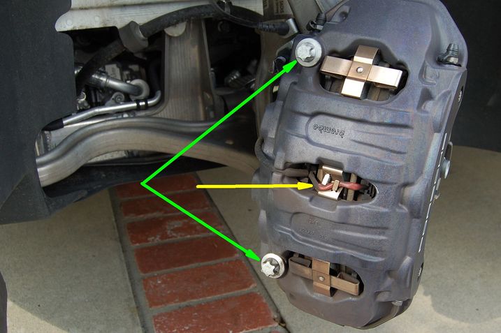

How difficult is it to replace the front pads on a Panamera 4? It looks like you have to remove the entire caliper and the tools needed look like they may be unique. Any thoughts?

The calipers are one-piece units with a permanent "bridge", which means no pad insertion window. As a result, the caliper has to be removed via the two mounting bolts (green) in order to change brake pads. The pads themselves are equipped with electronic wear sensors (yellow) that let the driver know when they are at their wear limit.
(Photo courtesy of Edmunds.com)
