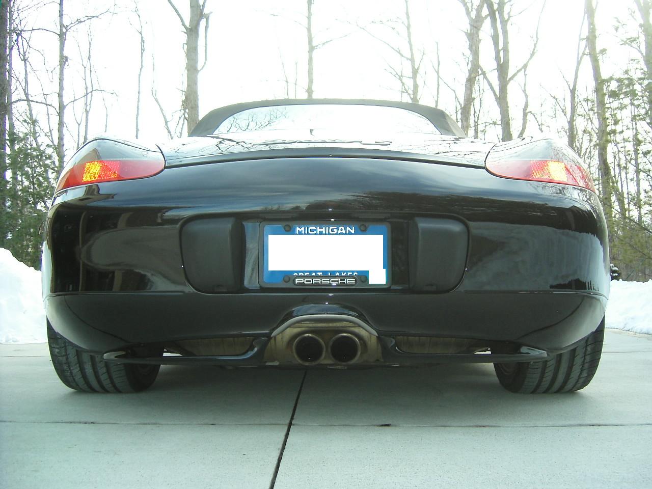

I have an '01 S with 18 inch wheels, also had PZeros that were not a very good ridde. I put Michelin Sport PS2's on it; it's a brand new car and the tire is plenty wide; looks great from the rear. Also, the sizes you mentioned above will be too wide for the rims you have. You'd need to go to wider rims to accomodate the width of the tires you're thinking about (or so I was told by my tire guy at Tirerack). Also if you consider lowering the car (like I did) then you'd really have rubbing problems. Check out attached photos of rear with diffuser (shows tires).
