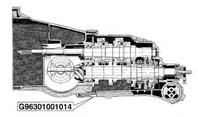

BTW - do you know where the serial number is located on the transaxle? I found a few cast-in numbers, but nothing that resembles the trans serial number that is listed on the build sheet printout I got from Suncoast.
Found the answer to my original question when I finally found my trans serial number. Build sheet says car should have trans serial number GA96002011587 and currently installed transaxle is GA96001022944. Looking at this chart in 996 The Essential Companion the LSD unit must have been replaced at some point with an open unit. :eek:
Kind of sucks, but from what I read, the LSD needs rebuilding fairly frequently. I'm not planning on doing much track time and the TC will help out in snow if necessary. Also, the replacement is 11,357 units newer! Still a bit bummed though. :unsure:
