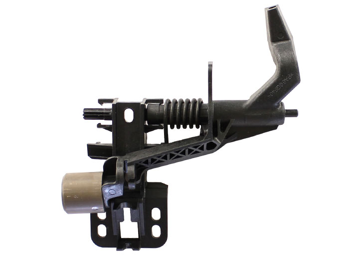

I pulled off the trim, and it appears that the spring on the axle bearing shown below came out of its normal position. After some sweat and tears, I seemed to have got it in a "good spot" but I am still not sure the way I oriented the spring is correct. The picture below is a stock picture.
The handle sits flush again and the window goes up all the way, but I am worried it will pop back out.
