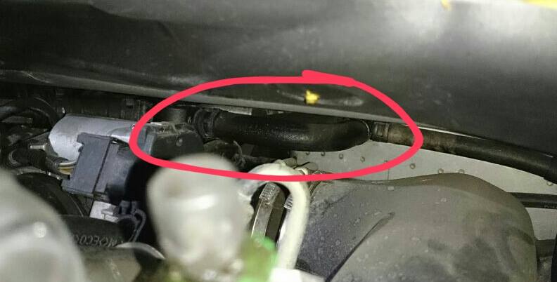

Failing to get my hands on a compressed air pump, I decided to spray some crab cleaner onto those accessible vacuum and boost hoses to see if I can any suspected leak.
It is funny to say that even with the suspected vacuum leak, the boost shown on the dash is stable at 1.1 bar and power delivery is smooth. I do not feel any power loss and the car is still as fast as before according to my accelerometer.
Since the new MAF, I have done just over 100km. The car has been occasionally throwing ABS/PSM CEL on the dash and the P0102 Factory Fault Code 115 - Mass air flow sensor, below limit was read. Furthermore, No other fault codes with engine, tiptronic or abs/psm were read by the durametric. Have you got any idea why it had caused the P0102 code?
In the attached photos, the 2 hoses that I circled in red are in fact linked together with part of it linking to the great black metal y-pipe that connects to the throttle body. Having sprayed some crab cleaner to these 2 hoses, I found that the rev counter definitely dropped and therefore I suspect there to be leaks. Fortunately, I was told that hose is the breather hose from the oil tanks mounted on the turbochargers. I also sprayed some crab cleaner onto the F hose that connects the 2 DVs, the Intercooler hoses and the hoses on the N75 boost solenoid but found no rev dropping. Do you think this breather hose is the culprit? And should I go out and datalog any particular value to narrow down the issue?
