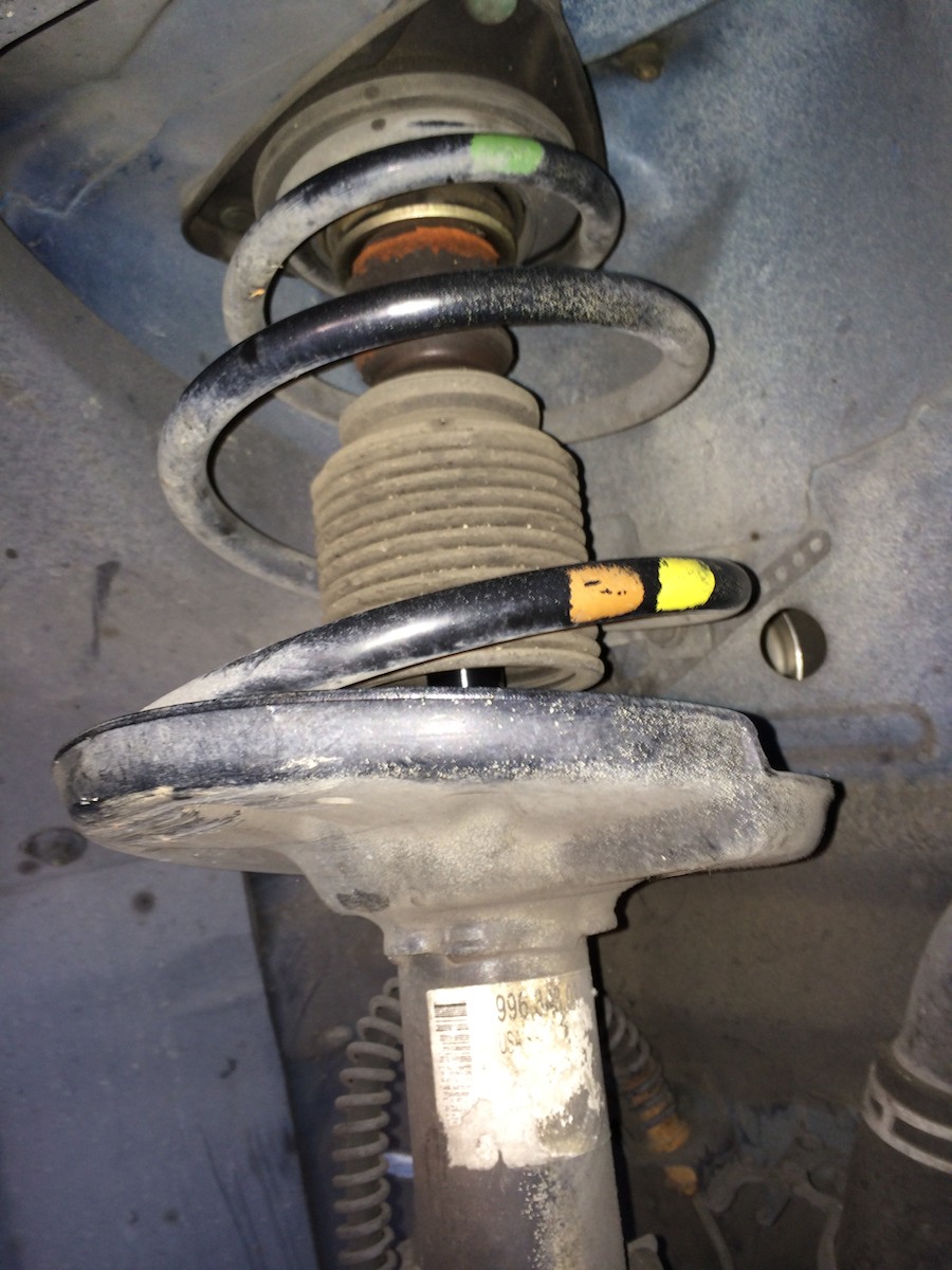

Finally got a chance to inspect my suspension. The colors are green at the top of the coil and orange/yellow at the bottom. see attached pic. Car is a MY99 Cab / Tiptronic.

Thanks Loren. The std front sway bar is 23mm (I thought) and mine is 24mm. Would Porsche have used a heavier bar on a Cab Tip as standard?
Yes, Porsche suspensions are tuned to the cars weight - so there are different components for Coupe and Cab as well as Tip and 6 speed.
So if someone wants to change the suspension you need to tell the parts people coupe or cab and Tip or 6 speed.
