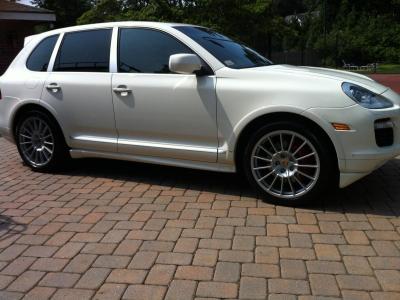

post-54843-0-79829100-1391109627_thumb.j
Upper and Lower Control Arms would need replacing around 100K from what i remember that is about $2,500. Honestly having a older one with all the issues documented and costs there is no way you could ever ever spend as much as you would trading it in on a new one. I have a 2K4 and it has 37K miles. My plan is to drive it into the ground for the next 10 years. It is such a blast to drive. Yours looks very nice by the way.
