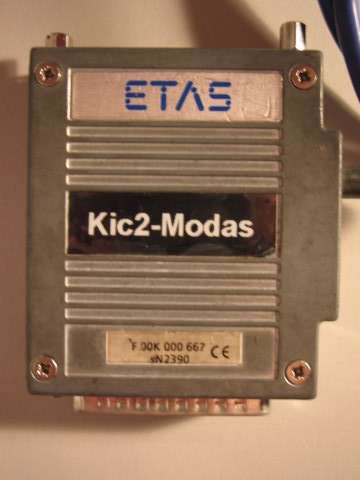

The 2003 GT3 Cup I worked on had MS3.1. I used the factory Modas system to connect to the DME. It doesn't connect to the OBD2 socket, but to the diagnostic connector on the roll cage, near the back of the right hand door. It uses the ETAS interface. Durametric do a version for the Cup car, but it isn't quite as comprehensive as MODAS.

Now I need to buy, rent, borrow a MSAII box/cable. (PMNA says they no longer have them for my MY03 996 Cup car.)
