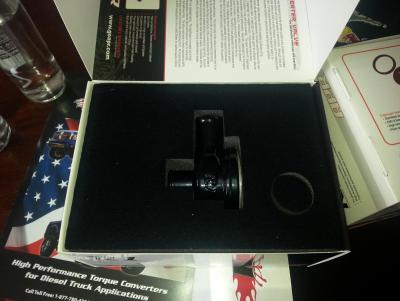

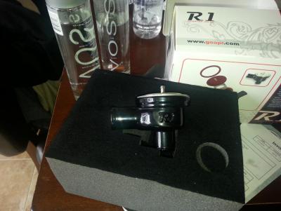

Diverter valves arived ahead of schedule!!! Packaging is great, nice foam cut out. Valves look good. They have a great finish. Time to install

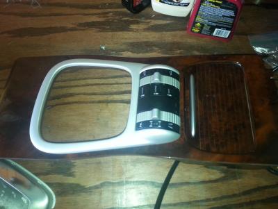

Heres a picture of the polish knob trim. Any one know a good way to get swirls and scratches out of the wood grain trim? Tried rubbing compound, machine compound, didn't really help. Any Ideas?

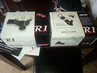

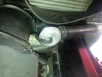

Valves installed. Passenger side was easy but the driver side as a pain. Autozone sells a tool for the oem hose clamps. Has a extended cable and clamp. 30 bucks and worked great!! Both Wheel well covers needed to be removed. Valves can really only go in one way due to the position of the 1/4" nipple. Just remember which way that faced and you wont install it backwards. the valves are bigger than the oems so im a little worried about the other hoses in the install area rubbing. Well see if there's any issues. Wish i could start her up!! post-94280-0-11845400-1395955335_thumb.j Oem Vs APR
post-94280-0-81456400-1395955523_thumb.jpassenger valve
post-94280-0-81536200-1395955506_thumb.jDriver side valve. You can barely see it
post-94280-0-42095900-1395955537_thumb.jPassenger Valve installed

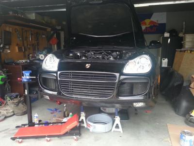

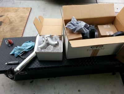

All parts are here!!!! time for the fun! Ill start taking picks as everything comes apart. Heres some pics of the exhaust and the rest of the packages.

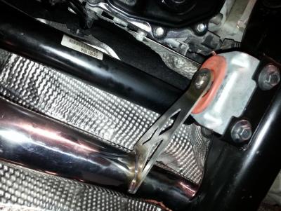

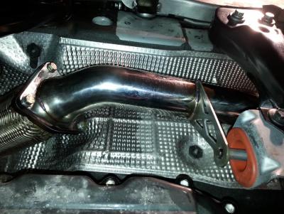

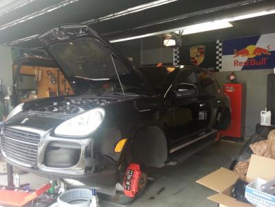

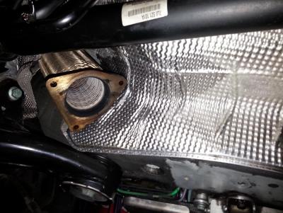

Alright, Cat deletes are installed. I found it easy to soak all bolts for about 20 min then they came of fairly easy. Driver side flange was a pain The very top bolt is in a tight spot. Had to remove all the hangers and finagle a wrench between the pipe and the shaft. I eventually got it. The one bolt took me about 20 min. All new bolts were doped with anti seize just in case.The driver side hanger may be welded in the wrong location. the hanger shaft is snug up against the rubber as you can see from the pictures. I'm going to send these to EVOMS and see what they think. Valve body is torqued and installed ready for fill. I'm going to cold fill it tonight and then warm fill it tomorrow when i get the rims and can get this thing on the ground. Not to comfortable shifting gears while shes on jack stands. The EVOMS intake looks great. I can see why its so expensive. Going to start work on that next. So far so good!!
post-94280-0-42181700-1396074241_thumb.j Driver side flangepost-94280-0-72093900-1396074256_thumb.j passenger side flange. Very easy. post-94280-0-39215600-1396074271_thumb.jDriver side Mount As you can see its alot closer then stock or the passenger sidepost-94280-0-66165100-1396074289_thumb.jPassenger side mountpost-94280-0-89901300-1396074346_thumb.jEVOMS Intake unpacked
