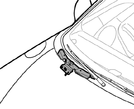

Where is Located the GPS antenna (not the ones embedded in front glass)?
Today I changed the front window and now my PCM does not find the GPS location. All the terminals of the antennas embedded in glass have been connected. In the information menu reads 0 Satellites 0G gps.
Any suggestion?
Thanks to all
In the cowl panel.
Make sure it didn't just get un-plugged when they installed the windshield.
Thanks for the quick reply, but I think that is the thelepone antenna, not the GPS. I'm wrong?
Let me know.
thanks again
The title of the service manual section I took the diagram from is "91 13 19 Removing and installing GPS antenna − as of MY 2005".
The radio antenna(s) are mounted to that panel -- I believe the GPS antenna is under that panel.
