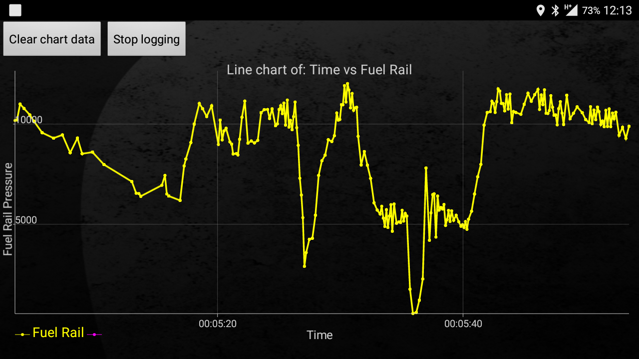

On a highway run there was knocking and shaking sometimes when accelerating above 3k rpm. Monitoring the fuel rail pressure while driving showed pressure drop to 10bar and after a while returning back to normal 40-100-120bar depending on the throttle position. About 6 months later and 6000km passed HPFP totally gave up with a rail pressure 5bar (fuel supply pumps pressure) reaching 10-15bar sometimes. CEL is on showing P1021, P1023, P1026, P0431. I am using a simple OBD2 bluetooth reader with Android app.
