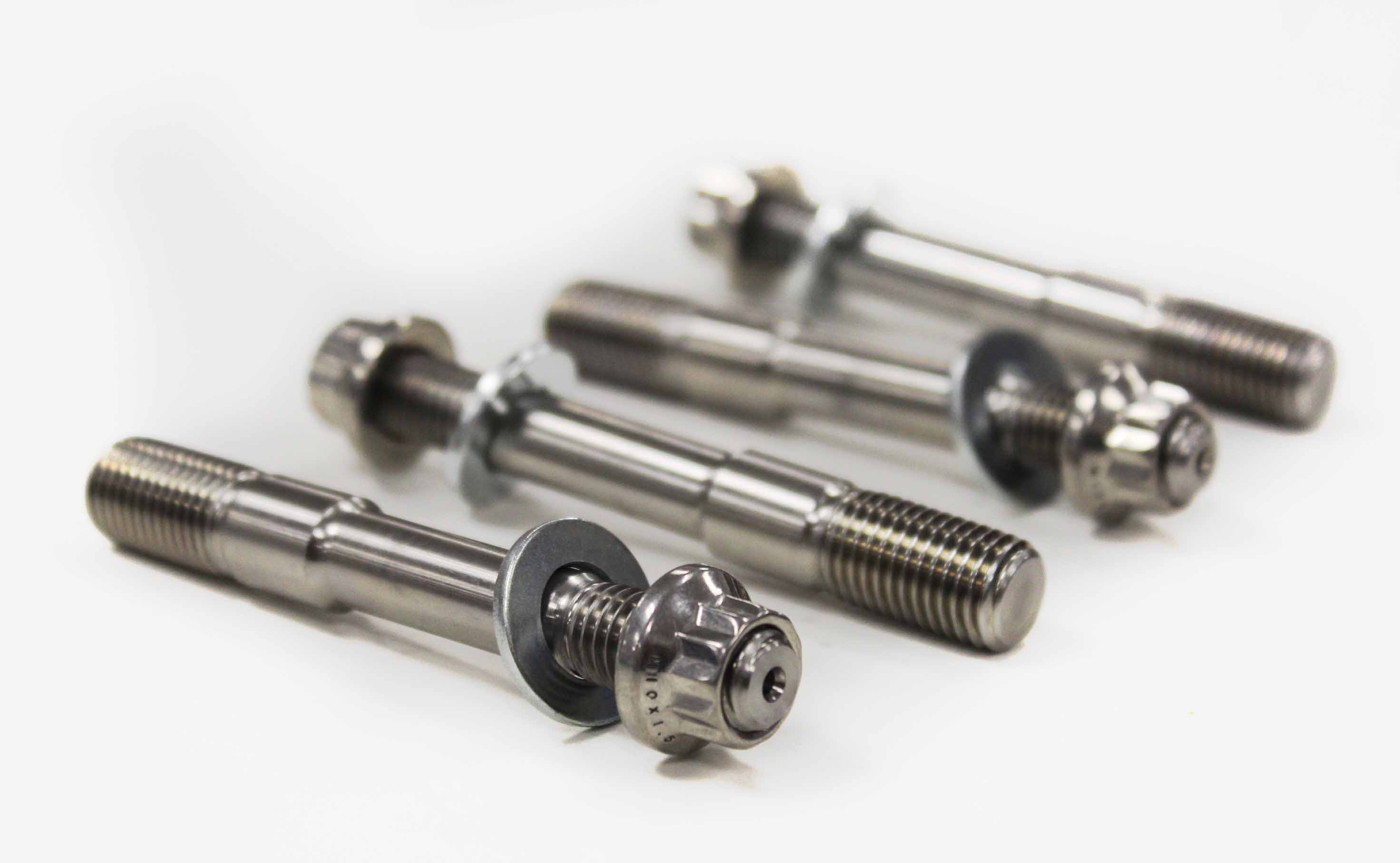

I had an additional thought on this repair; a couple of companies produce stainless steel replacement stud kits for mounting the calipers, like those used on the cup cars.  You would still need to do the Time Cert repair, but instead of using new caliper bolts, you would install the corrosion proof stainless studs which would never have to be removed again.
This would add about $100 to the project, but you would never be faced with a repeat of the problem you currently have.
With studs it will be difficult to move the caliper from the hub i guess. There is very little lateral clearance around there, you can give it a try anyway.
It is not as bad as you might think.
