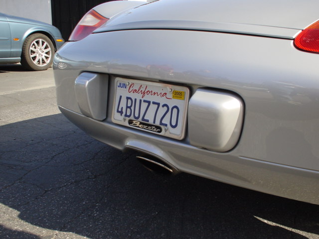

So I met Dell today for the first time at the local tech session. Hard not to notice the vents on his Box. Then he pointed out the plastic and rubber parts that had been painted silver. He said he prepares the surface to make it smooth, uses the proper primer, and a flex agent in the paint. The more a part can flex like the bumperetts the more flex agent he uses. No mystery, and exactly what I was told by the other 2 local body shop owners.

I agree. I have done this myself and nobody can tell that it is not factory. Painting plastic is different than painting metal, but it is not a mystery. I used a plastic bonding primer, regular sandable auto primer, sanded and reapplied several times to get a smooth finish as opposed to having the pebble grain look to it. Then I applied the appropriate color silver and then a glossy topcoat. I have not had any peeling or any problems at all.
