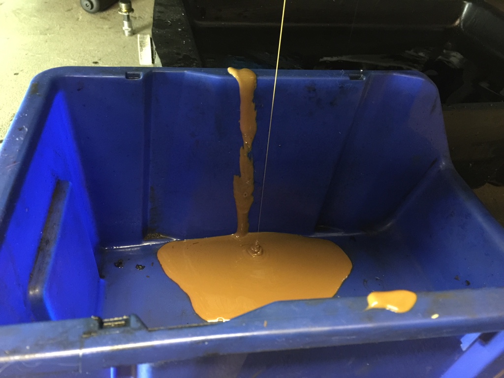

Started draining the fluids today and I think I know exactly what you mean by "chocolate shake"
Any possibility you just blew a head gasket?
If a head is cracked, perhaps a local machine shop could rebuild/repair your heads rather than replacing the entire engine?
