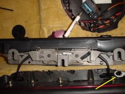

TP, My problem is my alarm control fried and locked the levers in the door sill and I need to know how to fix the problem. The dealer has replaced the controll unit and reprogrammed but the levers are still locked down. Where is the solenoid and how do I replace it?
I do not have a picture of the soleniod because I have never replaced it and it is hidden in the door sill. The solenoid is connected to the round white plastic thing with the line to it. That round thing moves foward and back to lock and unlock the levers. The soenoid makes it move, but maybe it can also be called a motor.
