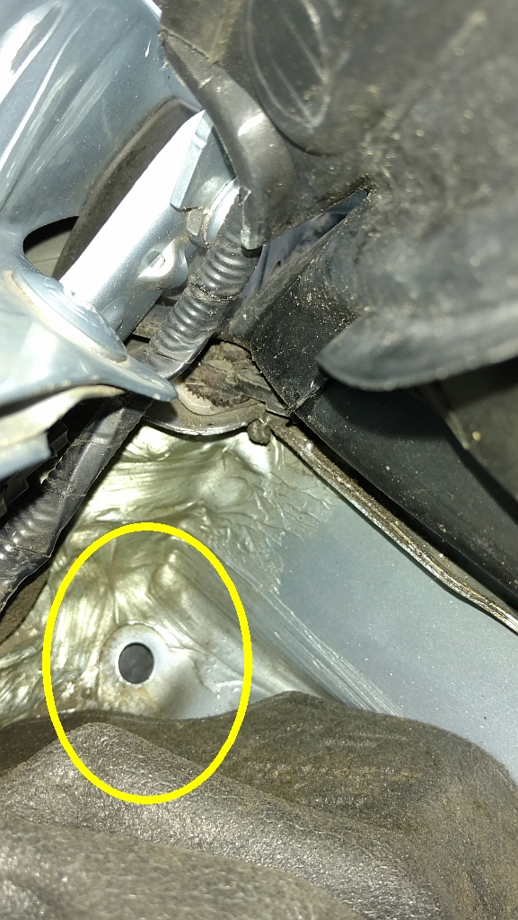

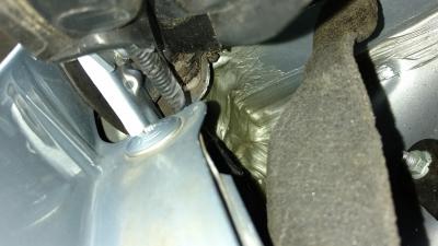

Here is a photo of why..
post-67622-0-89300800-1448993881_thumb.j
^^ The general area - the foam barrier is shown. The water from the windshield runs right down around the hinge-pivot that can be seen in this photo.
post-67622-0-15285900-1448993883_thumb.j
^^ And THAT is where the leak was. The black thing seen through the hole is the hose for the sunroof drain where it runs through the fuse-box area. Once the munge built up enough to block water draining along the firewall - it backed right up to this hole - where it happily leaked into the fuse compartment, ran down the drain hose into the side kickpanel, and then into the foam rubber under the carpeting.
As far as I could see - this hole (probably there to feed wires from the fuse box to something) never had a plug in it. It does now.  Only took about 5 years to track this down.  To really see this you have to pry up the cowling (two 1/4 turn fasteners in the area) plastic, then move the foam barrier out of the way, and use a nice bright flashlight.
If you have a leak on that side - worth checking. Takes about a 3/8" body plug.
Saw someone post on a forum - about a 2013 Cayenne - that had a leak in the same area. Dealer said the robot sealing the seams in the area apparently ran out of goop. Required massive disassembly to fix. In this case - I think the robot or worker who was supposed to install that body plug was asleep on the job.
EASY fix - once found.

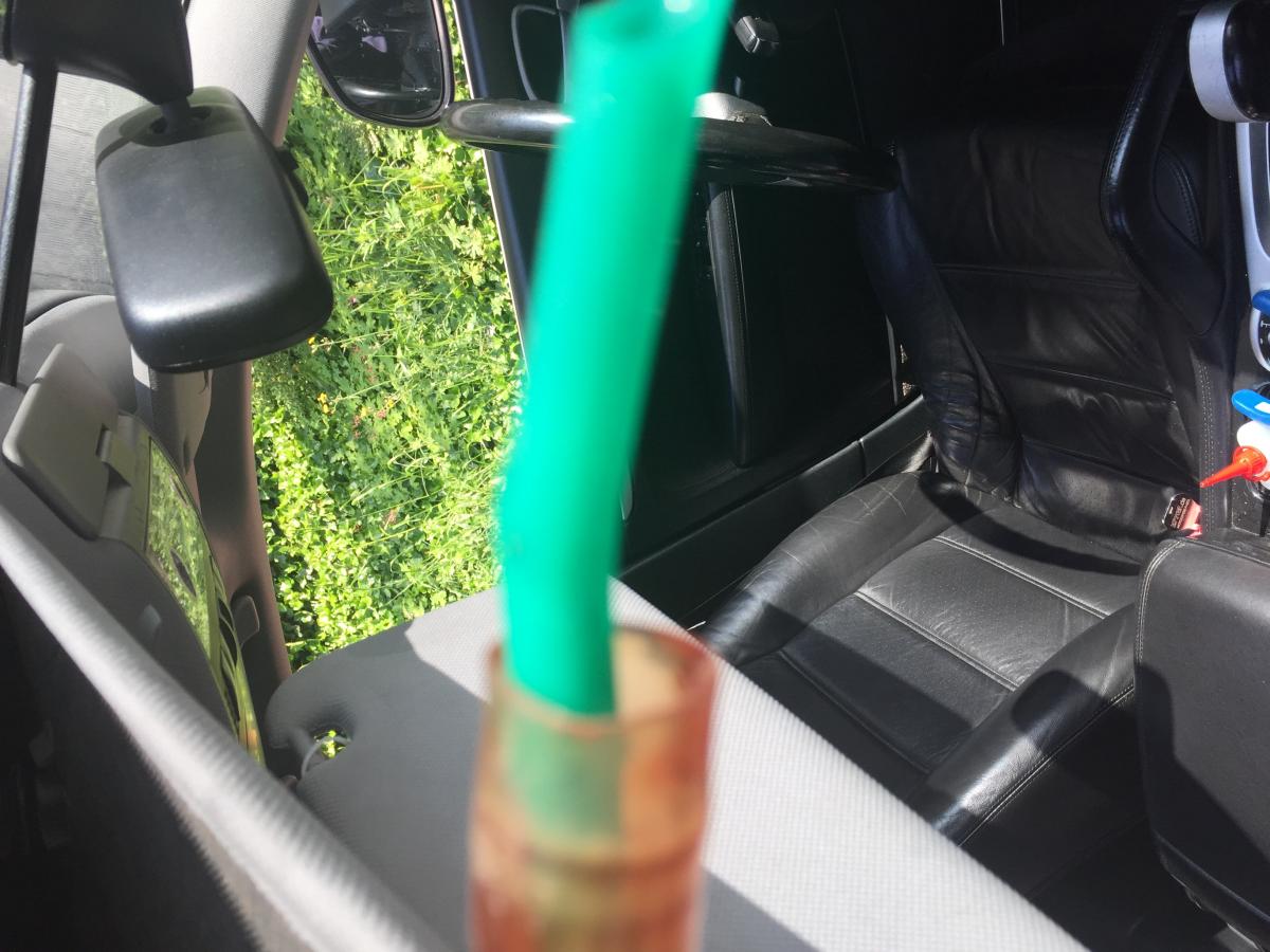

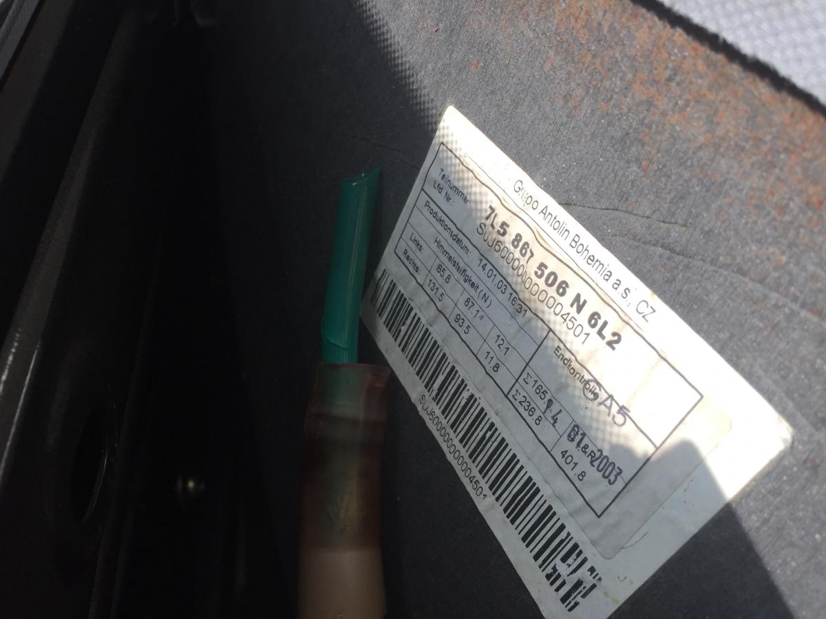

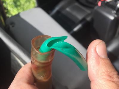

I know this was discussed already many times but i cant solve this water problem. My first S stay outside now for 3 years. Engine has a scored cylinder. Thats why no moving. Since i bought my Turbo the old car was moved only a few times for some km. Of course there was always a water problem which i could solve but now... Nothing.
I took apart the a pillar trim and the headliner. Could get acces to the hose. Disconnect the hose from the reservoir which is sitting in the sunroof frame. Found a hose with onother green smaller hose inside. This is i didnt know. The green tube was split. Dont think its normal. I used a bowden cable to clean the smaller tube. I can get inside for about 120 cm. Then its stuck. Normal or it should stick out somewhere? I am really dissapointed this cant be solved. Would like ask:
The inner green tube has to be completely inside the grey hose or it has to stick outside and ending in the reservoir?
How to replace the entire green tube if its closed and cant be cleaned?
Any help which can take me out of this is welcome.
I could not solve the problem. Solution bought a hose. 2 m. Connect it to the reservoir in the sunroof. Routing like the original. Just on the dash board i go down passing the fuse panel to the floor. Carpet still wet. Will see how i can route it under the carpet.
