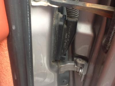

On my car, there's a large, black connector between the door hinges which presumably carries the wiring loom.
Does that look in any way as if it has been disturbed / not fitted correctly?
Before considering a new motor, i'd look for instructions as to how to disconnect that connector and check that there hasn't been a water ingress / that the pins are as they should be and that it's clean inside.
The wiring looks fine on the outside and checking the connector inside will require removing the door panel. But this sounds promising. The water did go inside the door near the hinge. If the door computer has trouble communicating with the outside world it would have trouble controlling the passenger side window, like it is.
The black boot on my car appears to be attached with a small torx bolt at the bottom. I'll try to put a photo up of the one I'm referring to, which is on the body of the car and not the door itself.
On the assumption that the plug-in point is behind that black boot, it might be an idea to see if that is the case before looking at door panel removal, if that's necessary.
I'm just guessing here, but pin corrosion is a possibility.
