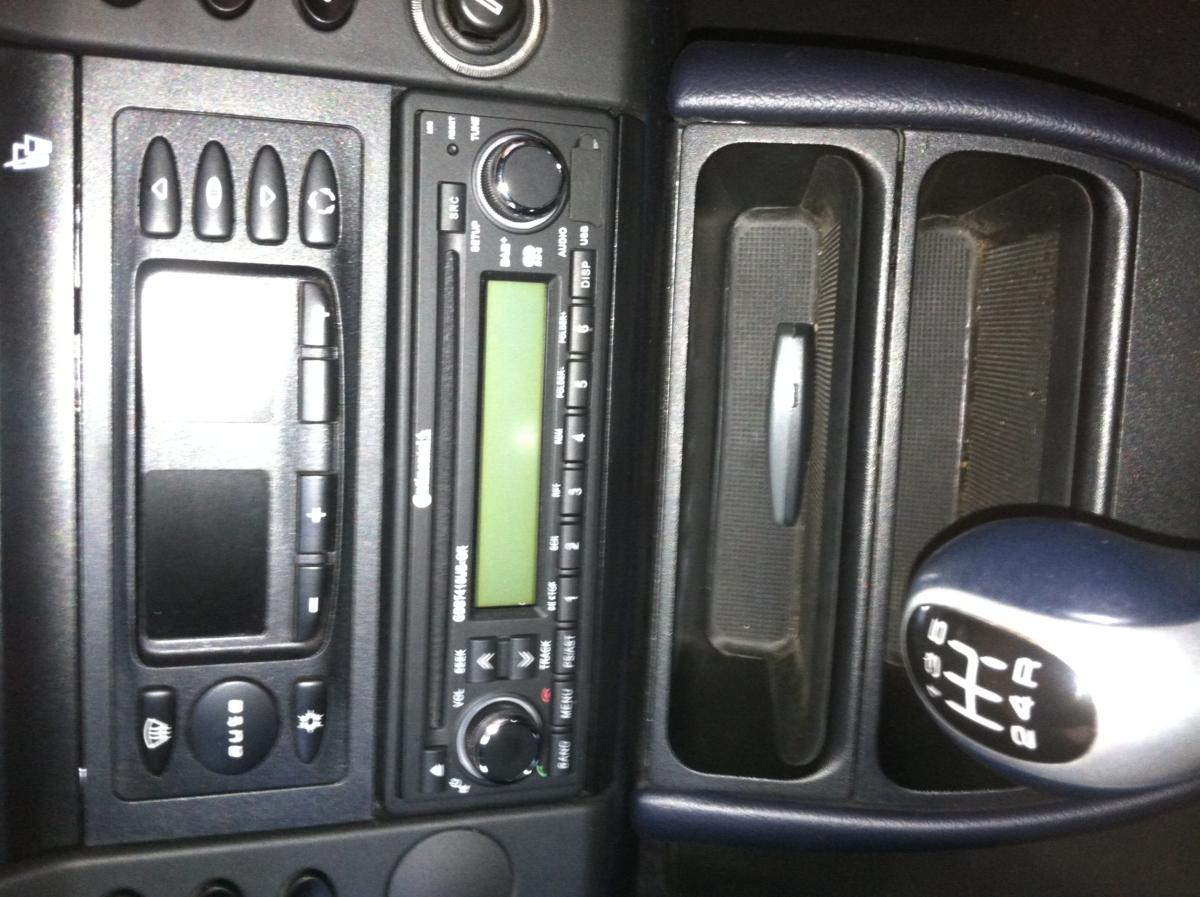

Just a thought, but if you have the center console apart, have you considered moving the climate control unit to one of the lower positions (where one of the 2 shelfs are located)? Not that the climate unit would be producing any heat, but moving to the lowest position might provide better air flow around radio. In my configuration, I have the cup holders (albeit useless) on top, radio below, CD holder (again, useless) below that and climate control at bottom. I still have the original CDR and have not had any failures, not even on the LCD. Also, does your car have the rear speaker kit? If so, (and I might be incorrect) but I thought those were powered by the head unit (amp only for front and door)... This could contribute to heat.

Just another thought... If you want to REALLY see if it is a heat dissipation issue (poor air circulation around head unit), drop the heat control to lowest DIN position (in your picture, where your lowest shelf is), and leaving the upper bay open (nothing there) drive around for a few days using radio/CD as normal. If doesn't overheat, then simply install the removed lower shelf where heat control was and you're done. If it does overheat, then I would start exploring other causes (speaker ohm resistance, amplifier, wiring, etc.). From my experience, start simple, then look for more complex issues.
Just to clarify, do you have an external amp, or are you running only the amp on the head unit?
This is one thing that I really like about the 986, four DIN bays. Makes moving things around pretty easy; configure as you like. I once thought I would like the radio in the top lower din position, and it was a good idea in theory, but the slight upward angle made the display hard to read with the top down, so it got moved back to the second (original) position.
