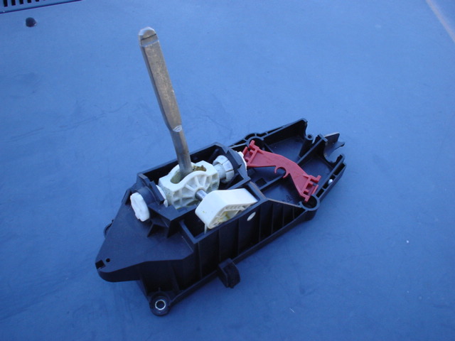

The first picture is the factory short shift for 997/987, part number 997 424 983 00. The blue tool in the picture is used to center the shift lever. The tool number is not 9619.

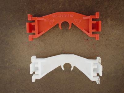

The second picture is the standard 996/986 shift and the tool for that shift. It is orange and the tool number is 9169. The part number for the orange tool is 000 721 961 90.
I have been trying to find the blue tool. It is not in the tool catalog. At out recent tech session I went through the tool catalog with the mechanic and we could not find the blue tool, just the orange tool that is way different than the blue tool. He then told me he seemed to remember that if you ordered the 997/987 short shift the blue tool came in the box with the shifter. If this is true then is is strange you have to buy the shift to get the blue tool.
If you have the blue tool shown in the first picture then can you give me any part numbers on it.
997.424.383.00 is embossed on the tool itself
Looks like you might be a victim of someone pulling the wrong part number somewhere along the line. 997.424.383.00 is very close to 997.424.983.00, which is want you ordered.

And how about a picture of the tool like this so I can see what it looks like.
Can you double check this tool part number. 3 parts guys at my dealer cannot find it in the computer. So today I went to my dealer and had the shop foreman who is the 997 PCA tech advisor look for it and he could not find it either.
The tool is identical to the two in the picture above except it is blue. The part number I gave is the only number on the tool.
