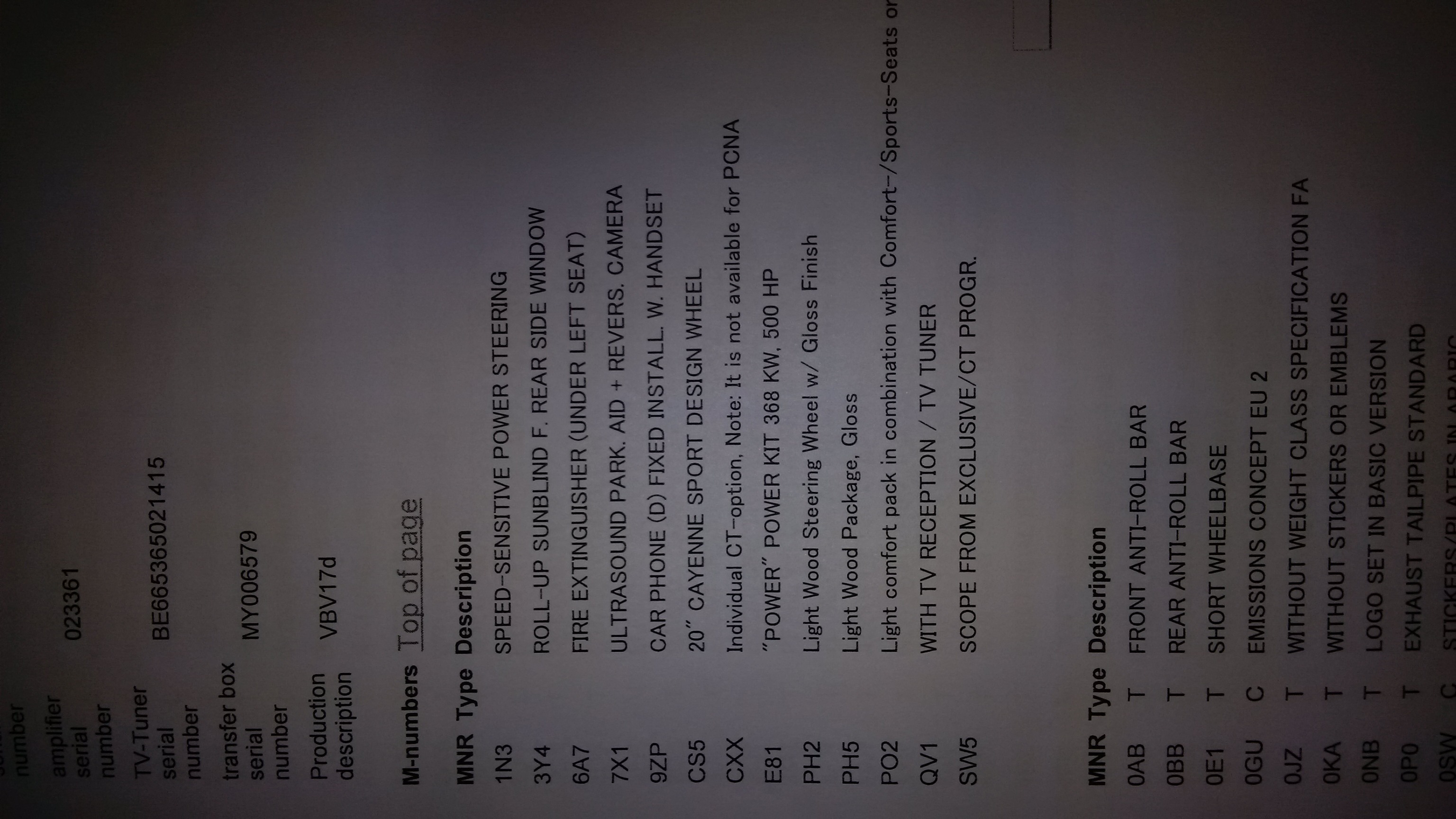

There was a Porsche introduced power kit with code name IE81 that did convert the stock turbo cars into turbo S variants.
It included the upgraded engine ecu, intercoolers, suspension components, brakes.
When incorporated, the letter "S" is stamped on the engine block.
Ive attached the relevant reference for your info.

Correct, I have the E81 factory upgrade to 500bhp with larger red brembo brakes all round.

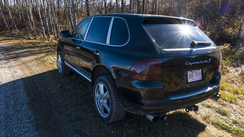

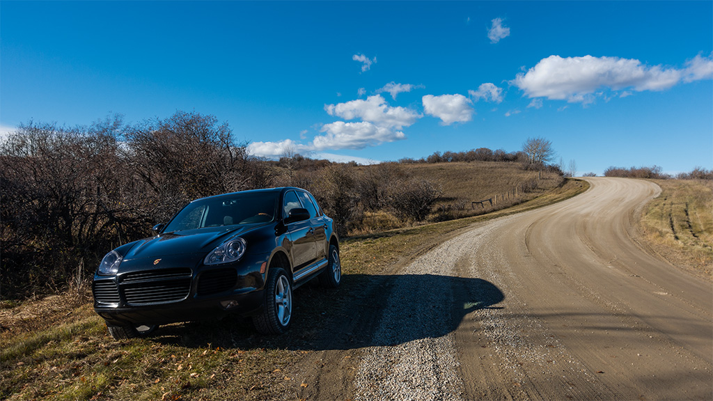

Sounds like reason enough to post pictures of the beast! I do get it dirty sometimes...this is with the 20" winter wheels on.CTT-02s.jpg
Still trying to figure out what the S really means on my specific vehicle - but the positioning is correct...

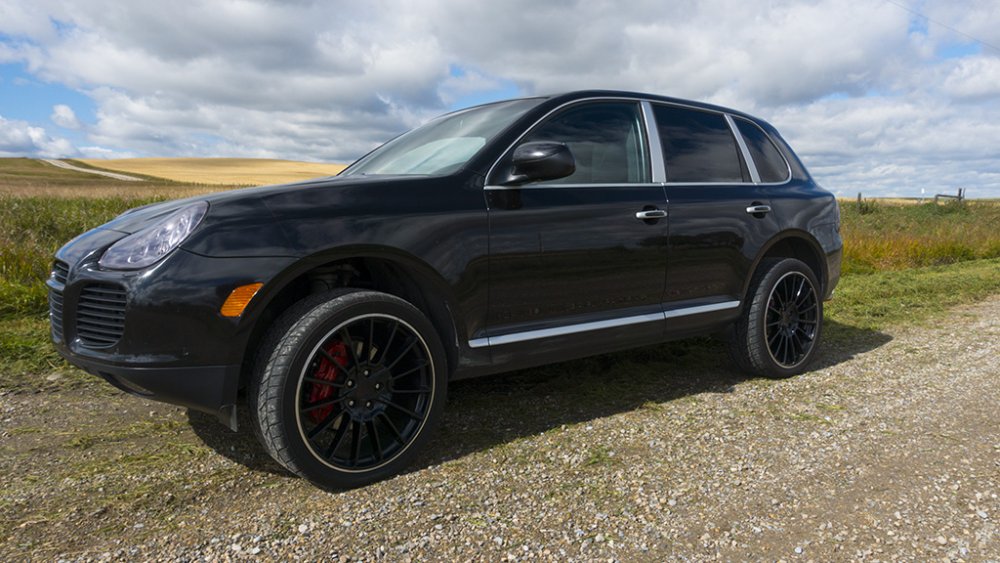

This is with the summer 22" wheels and spacers.
