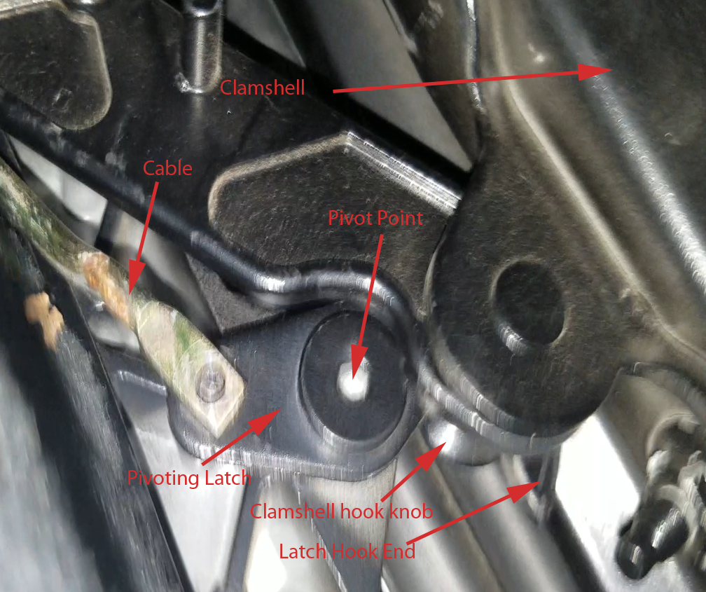

Now my problem is the top won't open.  When I go to raise it, everything starts correctly...the latch mechanism that connects to the windshield unlatches and then when it would normally open the clamshell, nothing happens except that I hear several relays clicking away.  I see no movement, hear no motors turning, nothing.  I put a camera down both sides to see if the latches on both the left and right side of the clamshell that lock it in place  are releasing, and they are still both locked, not just one.  There is a photo attached showing it latched. So I am guessing the motor that is supposed to move the cable to release them isn't being activated.

Thanks in advance for any help with this!  Here is a picture of the latch on t
