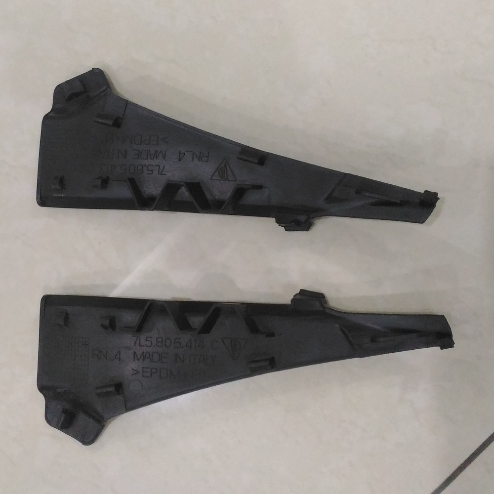

A workaround solution:
To remove the rubber covers so that the rain water does not flow towards the headlight anymore.
Result:
There is no more water "flooding" inside the headlights for the moment.
However, there is still foggy/moisture visible inside the headlight.
This is a temporary solution to avoid "water flooding" that may cause damages inside the headlight.
