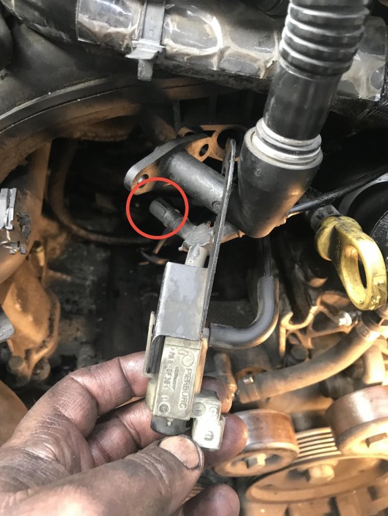

Hi everyone.  I was replacing my oil filler tube on my 2000 996 cab, and I broke one of these hard plastic lines off of a 3 way split.  I went to see where is was connected and the whole line came out in my hand.  can anyone identify what this part is, where it goes, and any part numbers to fix them?  thanks so much in advance!
Hey Stretch, yes I did figure it out.  It is a vacuum line to the vacuum reservoir.  with the alternator out, you can see the reservoir and the mounting screw that holds it in.  If you take out that screw, you can pull it towards you and reach the connectors. I can send you a diagram that someone sent to me on another forum to your inbox if you'd like.
