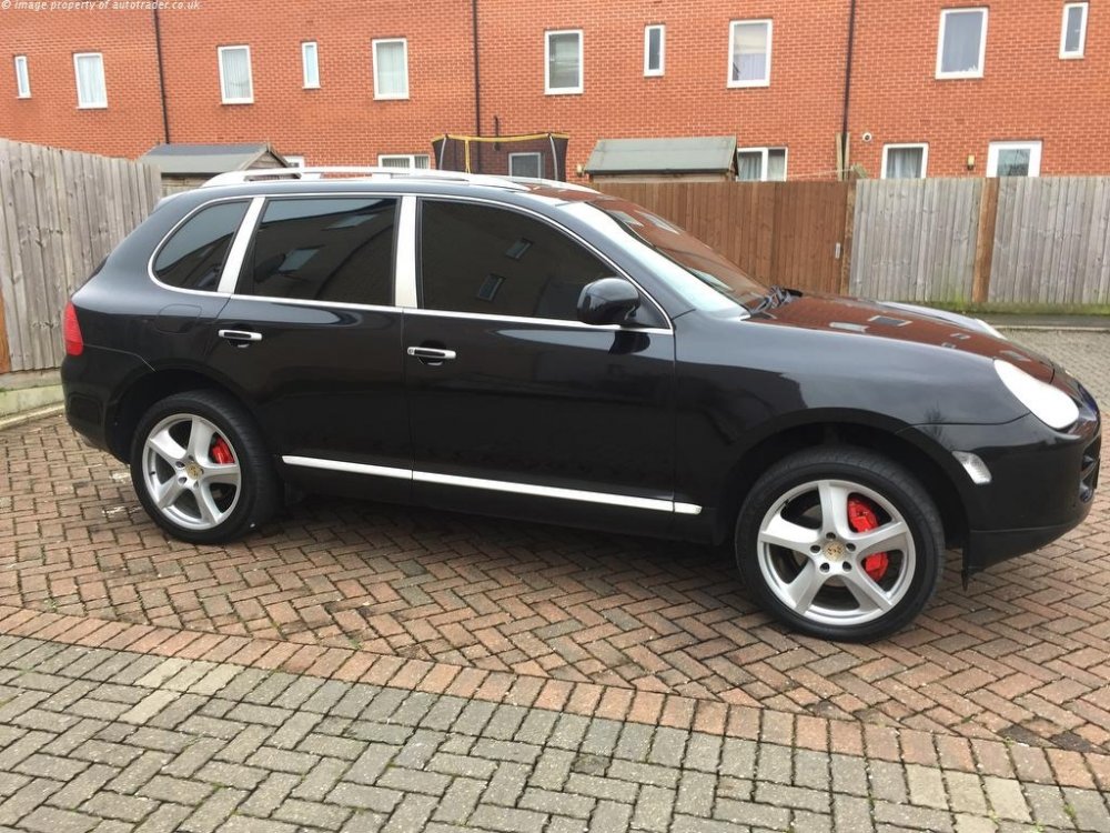

Yesterday I purchased a 54 plate Cayenne with 135K on the clock, the car really is in excellent condition, looks great, has detailed full service history, fresh MOT and has most the main problems dealt with already such as the drive shaft.
In the past i've had two 981 Boxsters but with a baby we needed something more practical and i've always wanted a cayenne, high mileage doesn't really put me off as long as its well looked after, I can deal with all but the most major mechanical problems myself and I like to have a project anyway, on the MG forums i'm quite well known for detailed threads about modifications and repairs as I've had a number of MG ZT 260s over the years including a full restoration of a written off vehicle, admittedly I did have some help with that so point being, id rather buy an older nice one out right and look after it properly even if it means getting my hands dirty.
I've attached a couple of pictures of my car.

Great looking p!g!
