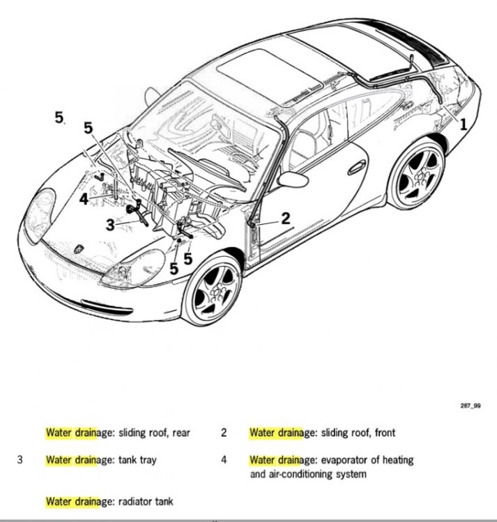

I proudly own a 2001 911 Carrera Cabriolet.  Should I remove the door plug to allow for drainage after washing?  My intent would be to open doors after washing, remove plugs to allow draining and replace plugs upon complete drainage.
Well, you can do as you wish but it seems overkill to me.  There are built in drainage holes in the  door that drain out the water, but they can be plugged up with leaves and debris.  Maybe check those for debris next time you wash the car.  Also a good time to learn about all of the drainage holes, especially the ones in the frunk area and check them for debris.
