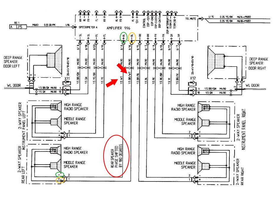

Regarding installing new aftermarket speakers... Please study the attached schematic of the M490 Harman "HIFI" system. Notice the areas I've highlighted for you. The reason is because you MUST be mindful of polarity. The aftermarket wire adapters will NOT compensate for the phase reversal that Porsche does on the rear speakers (notice the circle area) of your system. Personally, I would advise proper polarity alignments instead of phase reversal. This can be checked and confirmed with a multimeter.
Good luck!
