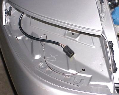

Sandy took this picture of the emergency release cable behind the driver's side tail light. Good place for it since you can't get to it. :rolleyes:
I did ask a mechanic how he gets to it. He shoves a thin tool under the bottom edge of the light and fishes for the cable.
My wife pointed out there's a lot more room under the bottom of the tail light when you lift up than it appears. We used one of her "knitting stitch holders" and fished the emergency release wire out in about 5 seconds. Problem solved. People are going to wonder why I carry it in my door compartment! Thanks, again for your quick response.
