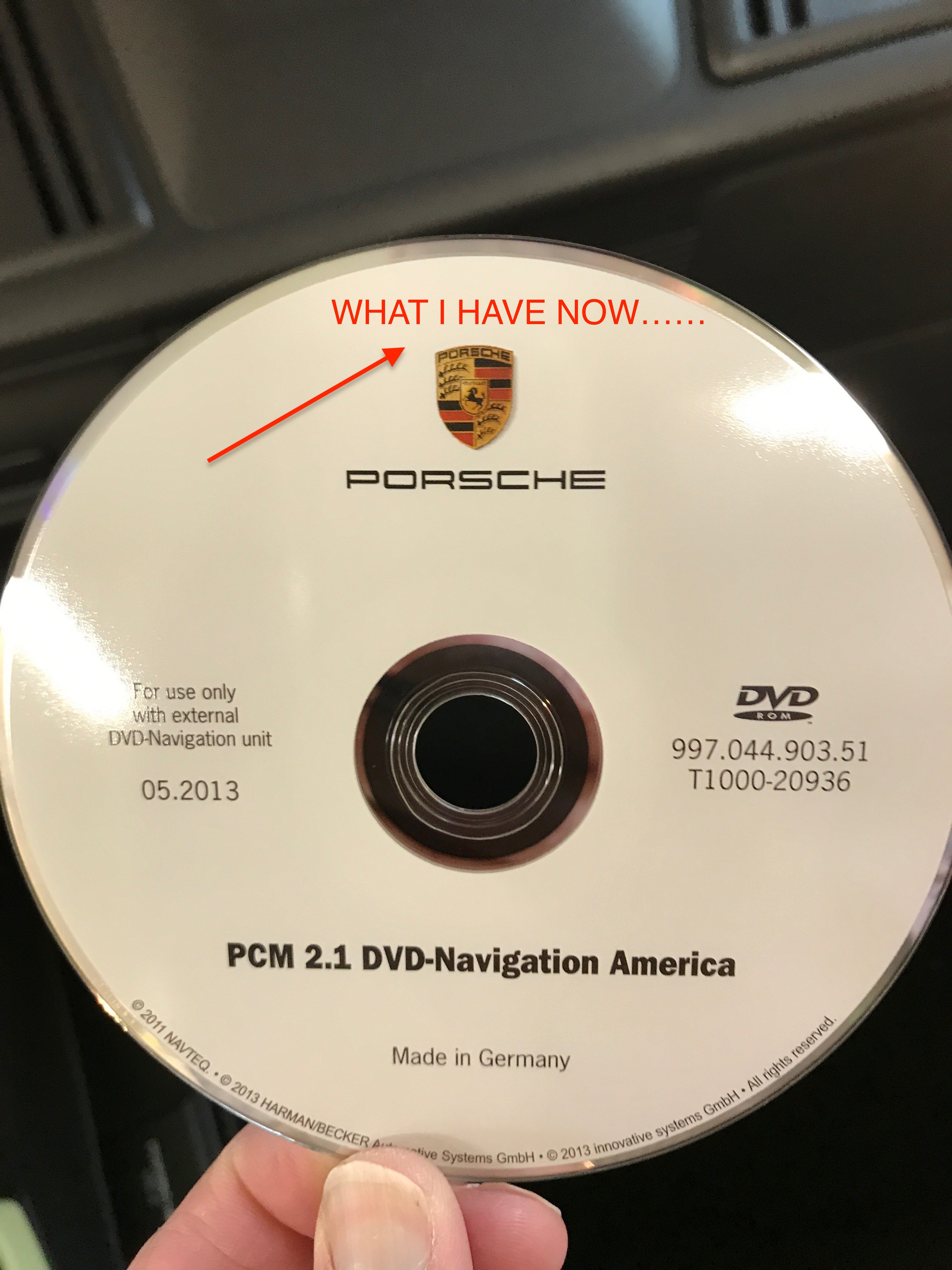

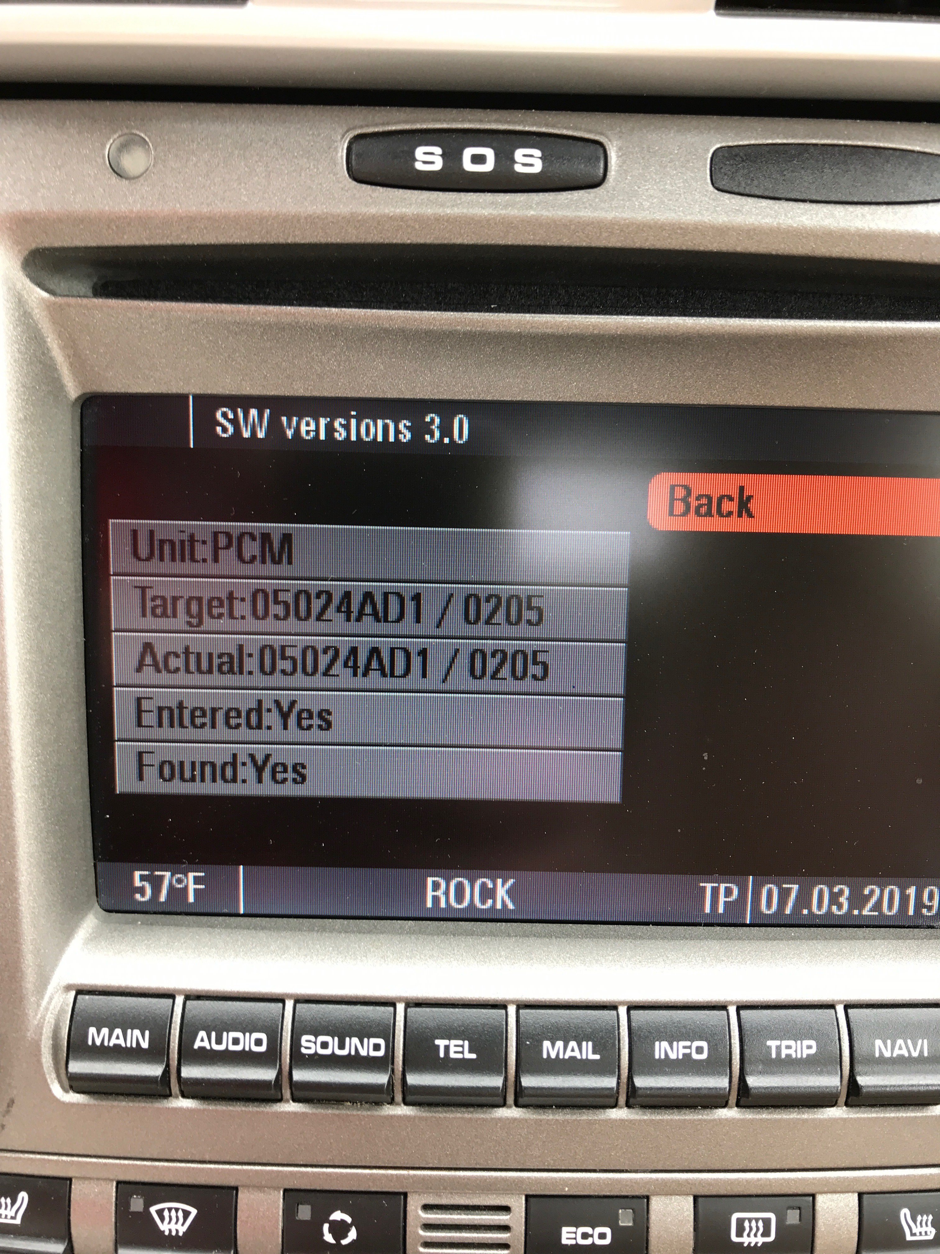

so I went to the local dealer to inquire on the above - updating to the latest version available for by 2006.  They gave me a part no. of 997.044.904.51.  But they could not tell me if it would work with my system or if there had been any significant updates to the cd since the one I now have - see picture.  Ive read that one must have the latest "B" version software for the 2.1 version.  But if I am reading correctly, I now have SW Version 3.....
Questions - can anyone please tell me the latest cd map version part no. for my model?
                      am I okay to use the latest cd without anymore updates - am I "current" for the latest map update cd?    Tks much.  I checked with the service writer and am still waiting.  They are stumped for some reason .
The latest USA map for PCM2.1 is indeed 997.044.904.51, which is mid-2015.  Because you are running the 2013 map, your system must have been updated in the past, so the new map disk would be plug & play.
PCM version 5024AD1 is software level B.  You may also have read that there is a Level C update, which yours must have had.  However, when you update from Level B to Level C, it only updates the Navigation Drive, not the PCM head unit.  If you view the software version for Navigation, it should show Actual:00179436, which is Level C for the Navigation drive.
Thanks Richard!  Actually I never did hear back from the dealer.....  Last question - as the latest cd update shows 2015, is there any way to tell if there might be another worth waiting for coming out sooner?  Rgds
It is anyone's guess, I'm afraid.  They used to release updates every two years or so, but these systems are up to 14 years old, so I guess they will stop supporting it at some point.  The updates are seldom up to date anyway.  If you put your DVD in a PC and check out the database file dates, they will likely be older than 2013.
