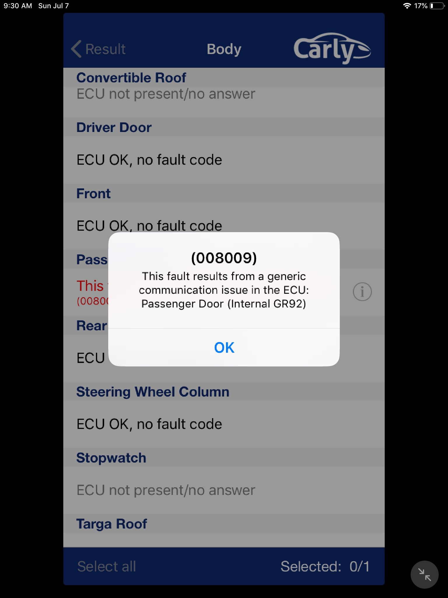

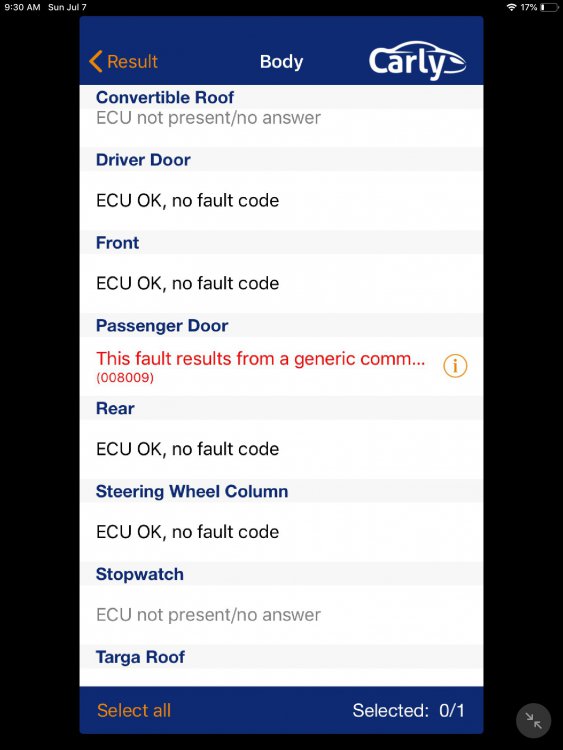

When I started driving it the next time I noticed an airbag light.  I used Carly for Porsche OBD / ipad app which pulled 5 bad codes (mostly expected after battery weirdness - PSM, etc) and I cleared all the codes.
The only code remaining is 8009 (or 008009, "internal GR92) which comes out as passenger door fault.
I've searched the forums and this either means passenger seat belt pre-tensioner or airbag sensor but I'm not sure.
Have tried multiple full battery resets and tried multiple times clearing the code but it returns w/airbag light on.

You can't reset an airbag code until the fault is fixed.
Fault 8009 Driver's belt pretensioner
Possible fault causes:
- Short circuit to B+/ground/between lines or open circuit in the lines
- Connection with other ignition circuit
- Driver's belt tensioner faulty
- POSIP triggering unit faulty

Are you sure driver’s side?  Everything I’ve seen says passenger’s side.

17 minutes ago, Alan Miller said:
Loren - do you happen to have the Diagnosis / Troubleshooting section below Fault 8009 in the manual?
Thanks,
Alan
What I posted is what is in the manual - possible causes - period.
A PIWIS diagnostic tester may tell you more - or the expensive swap out components.
