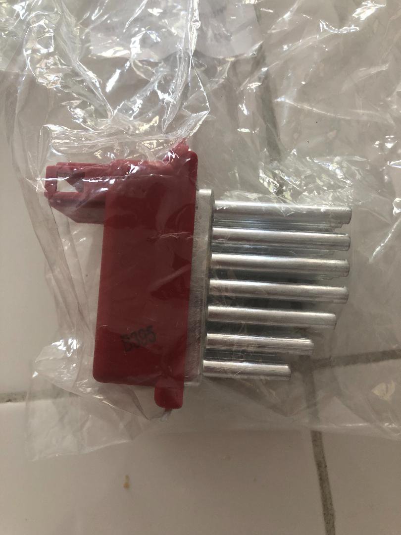

My 2000 Porsche 996's heater/AC fan wont turn off. Dealer said that the HVAC Blower motor resistor pack has failed. They recomend to replace the ac resistor. I got the new part but can't locate where to install it.
Please help,
Thanks:)
For LHD cars: yes,  passenger side towards the middle at the top.
