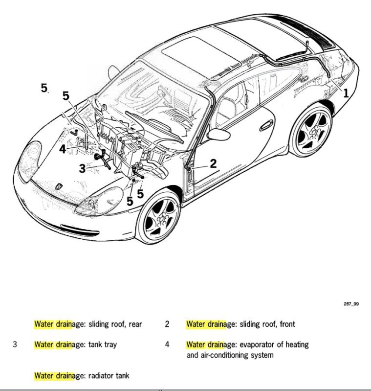

d) noticed under the rear passenger seat was wet along with the carpet under the seat...read about the drain need the wheel well, need to check both at the rear, but I can't visualize the ones at the front
#1 and 2 are on  both sides of the car and serve to drain the sun roof rail areas.  Remove rear wheel liners and there will be the bottom part of the drains.
#3 and 5 are under the covers adjacent to the battery.
Edited by DBJoe996
thanks!
How do I access number 2?    opening the door?  or remove front fender liner?
3 and 5...I have removed the passenger side cover....noticed the cabin filter was in there...i'll have to dig around more...or look for somebody that has actual photos
For #2, open sun roof and carefully pour some water in the front rail area.  It should drain out just behind the front wheel.  I believe to access the bottom of the drain you would have to  remove the wheel liner.
For #3 and 5 just look in the bottom of the areas adjacent to the battery tray.  You will see the black rubber drain holes in the bottom of those areas.  Just make sure the drain holes are not plugged by leaves and debris.  You can either clean up everything with a shop vac or run some weed whacker line down the holes to make sure they are clear.
