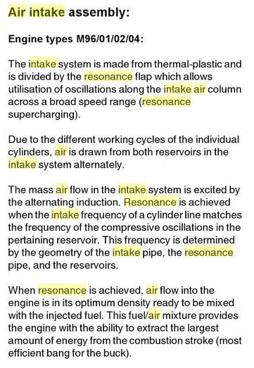

The second thing that comes to mind is the change over in the resonance flap.
