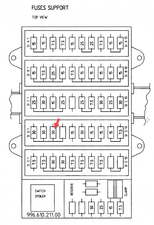

Start with the fuse -- D3 should 30A.
Remove it and test the fuse with an ohm meter.
D3 is in the fuse box by the drivers left leg. D3 is 4th row down and 3rd fuse from the left.

The fuse seems to be okay. The windows will go up if the top is clamped shut, so that says to me that the micro switch is okay. (correct?). Is there something else that you would suggest? Thanks.
