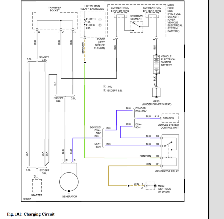

Check MB23 as you have already checked GP25? Check the fuses.
The alternator must have windings excited to make power so it could be on the regulator side of the system with a problem with low voltage, Bad ground?
Here is the Charging Circuit.
