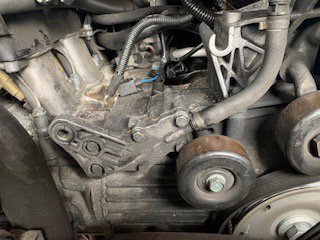

Hi Everybody,
I need some installation advice, please.
The good news is that I got my 996 alternator out of the car but I can't get the new one into placement.  I watched a few video and some  youtubers either cut the process out of the video or put it in with ease.
Any hints?
Thanks!

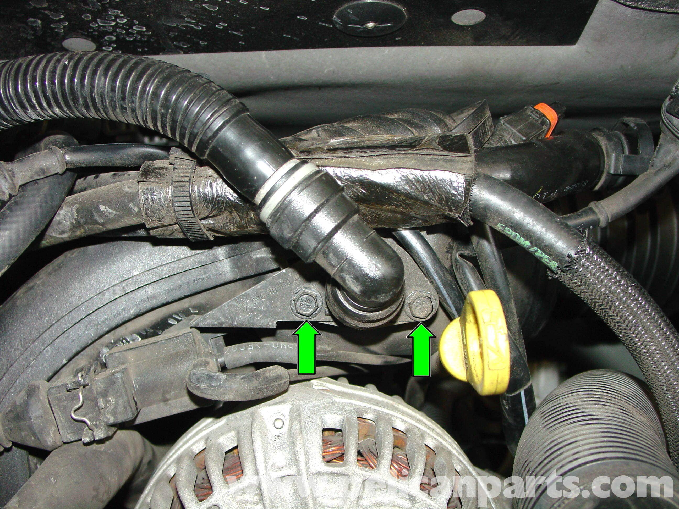

Hi, my experience is that the alternator installation and removal are quite easy once the small fragile hose connection is removed. Hose to Oil Separator - 99610622652, yes you loose little coolant but it is no longer a struggle.
Great time to replace it with a new one ore better yet an aftermarket ally piece.
Sent from my iPad using Tapatalk
Take a C-clamp and push the back bushing in so it is flush with the bracket.  If it doesn't move into a flush position it will be difficult or next to impossible to get it in.  If I remember how I did it, hold the alternator up and get the left bolt started but not tight.  Then rotate the alternator to the right and it will/should drop right in place.  Do not hammer on the bracket, it will break easily.
When you get the long right bolt in and torque it down, you will hear/feel a pop as the bushing moves into place.
