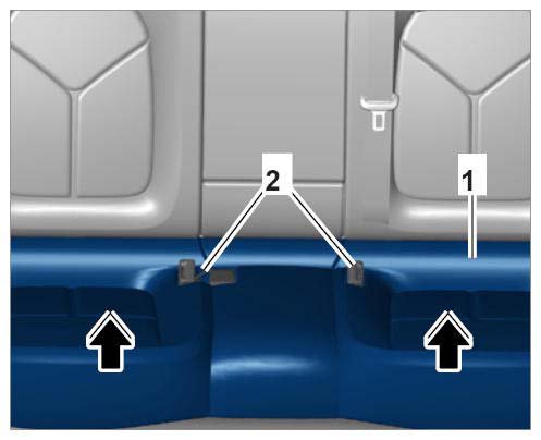

Pull up entire surface of 2. rear seat -1- at the front -arrows- .
Guide seat-belt buckles -2- out towards the holes in the rear seat and adjust rear seat to upright position.

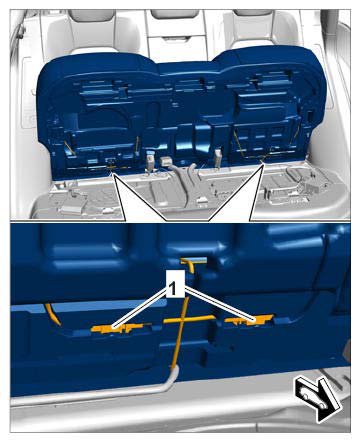

Disconnect electric plug connections -1- for heating elements.
Information - The number of electric plug connections can vary, depending on vehicle equipment.
Remove rear seat.
