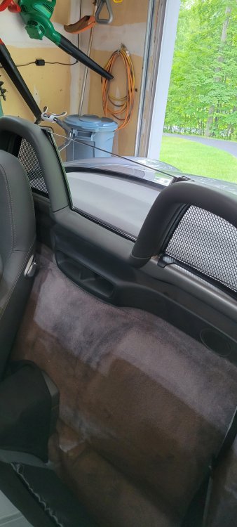

I thought I would revive this thread in support of the ease of installation. Earlier in this thread someone mentioned "test fitting", and that's what I did. To make the test easier, I riveted the lower support to the center padding and put it in position w/o the nylon fasteners. I hope this helps the next to do this effective, and simple install.

Also easily installed the factory kit recently purchased from Suncoast.
The pre-drilled holes make all the difference - almost can't go wrong.
Careful to line up the bolts correctly before pushing the pads back on....easy to bend one of the screws.
